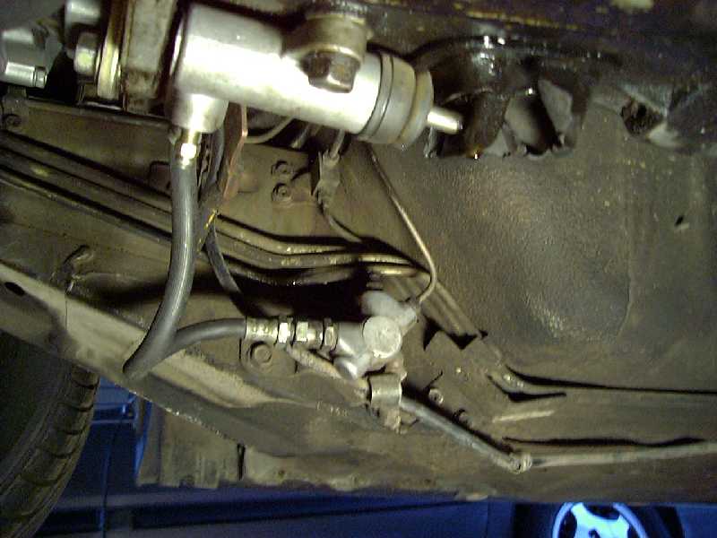

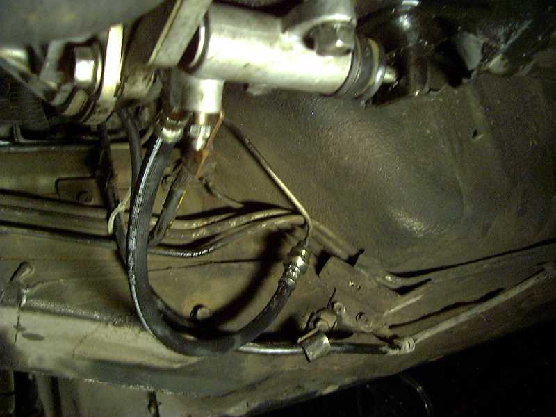

    Also, is the clutch master cylinder and hydraulic line the same from 84-89 or will I need to get an 87-89 master cylinder and line if I go with the FS5R30A?
    I have this book marked as an upgrade for the hose, someone posted it, can't remember who. https://www.summitracing.com/parts/e…3erl/overview/
    The hardline, clutch cyl, clutch damper, slave cyl, hose from slave to damper should be all the same.
    But before you go swapping stuff, decide if you are going to use the Clutch Damper. I am deleting it off both my stick cars at some point cause they can be a PITA, another step in bleeding and on my 87 the bleeder broke off. There's a write up on ZBum's mirrored page http://zbum.suomiz.net/modification.clutch.damper.shtml showing how to use a 280z brake hose to bypass the Clutch Damper. (pictures off zbum's site)
    If the hoses are the same, just different length, you could probably just bend the hardline over. I've also seen a piece to replace the damper for sale somewhere. I was going to make a little piece of hardline up to replace the damper if it will screw into the factory line or see if that 13inch braided line is long enough.
    Good info. What is it's use for? Does it give different pedal feel without it? Being used to the early S30's, when I read that being there I was like hugh?

    I have heard of someone using the 280zx brake hose to bypass the clutch damper before. It's supposed to give a more positive feel to the clutch instead of the sloppy feel. However, I read up on the purpose of the clutch damper and it seems like an important part even though it involves an extra step to bleeding the clutch. It is supposed to reduce vibration in the driveline created from engine oscillation ensuring longevity of driveline components. Therefore, I haven't decided if I am going to use the clutch damper yet or not. Still, this is good information and it should be stickied.

      Without the damper you push on the clutch pedal, the master cly pushes the fluid to the slave cyl, clutch fork moves, clutch disengages. Release pedal, opposite happens. It's a direct link between slave and master cyl. Adding the SS line may even help this more over the 30 year old rubber hose.
      The damper introduces a delay in response, mainly when pulling away from a stop, so if someone lets off the clutch to fast (ie new stick drivers), it's supposed to help lessen "dumping" the clutch. At least that's what I think they had in mind for it. It's another insulator from the car, just like the sloppy 60a hardness bushings/mounts/insulators.
      This could also be an issue for higher horsepower Z's if it causes clutch slippage.

    That is odd. I'm not sure how that is possible. Dunkine description makes the most sense, at least to me.
