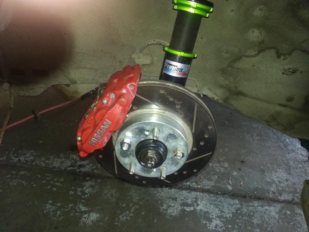

    I have Alex's old 95TT front brakes on my 86T with a Z32 master and they do the job pretty good with around 250hp
