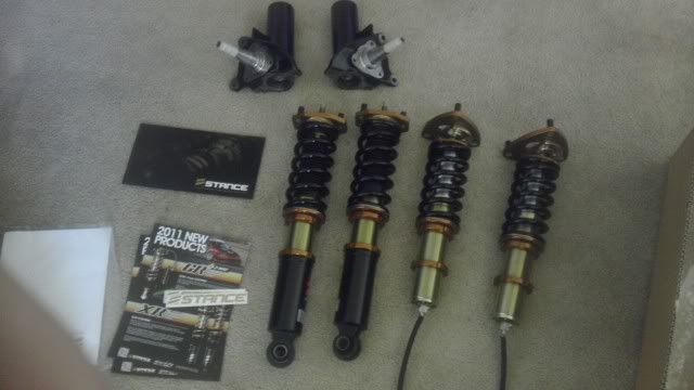

    STANCE Nissan Z31 GR+ Coilover 9k/7k
    Click here to view my Stanced VG33ET Build thread / Click here to view my Feed Back thread
  • #19
