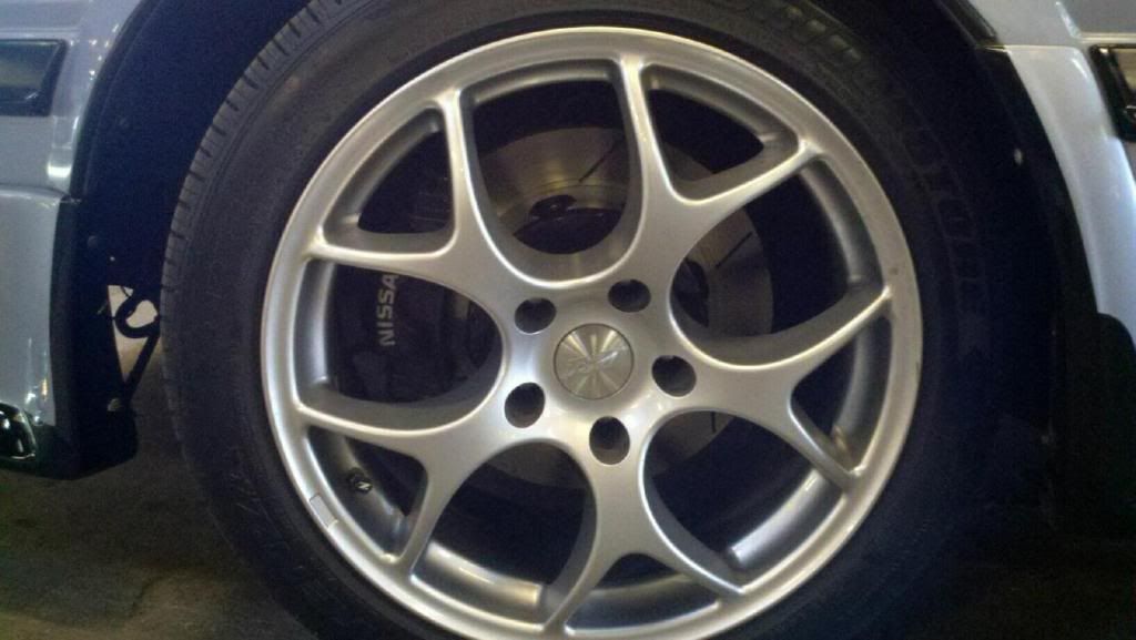

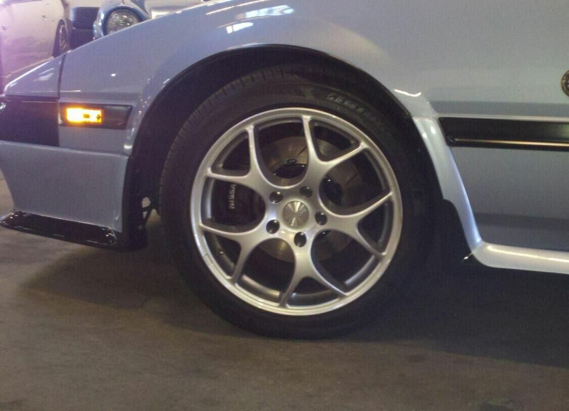

  • I finally got the write up for the WINFactory BBK for the z31
    The WINFactory Z31 Big Brake Kit is perfect for the daily and light track use drivers. Features a 2 piece aluminum hat and 12" slotted GT rotor, which shaves 3 pounds off the rotating and bounce mass of each wheel. The kit also relocates the rotor to the outside of the hub for ease of maintenance. With the additional rotor size you will use less brake pedal pressure to stop the car and with the improved cooling vane design you will also notice less brake fade during hard braking use.
    …All while still utilizing the stock caliper. Other options are available, call/email for inquiries.
    Kit includes:
    2 - 12" Wilwood rotors
    2 - Wilwood aluminum hats
    2 - Winfactory relocation brackets (1 left, 1 right)
    10 - 8mm longer wheel studs to relocate the rotor to the outside.
    and Grade 10 mounting hardware!
    $600 for the stock Z31 BBK upgrade.
    Matt at 916.457.7062 or tech@drivenauthority.com
    Best argument for this set up? It's complete .. you don't have to search around, looking for all the stuff/parts.
    Can you (anyone) get a better deal? Yeah, if you want to take the time and effort to do so. Matt/Driven Authority will stand by his kit. You can assemble your own kit - develop your own bracket (one -off) .. but put a kit together for mass (so to speak) sale ..
    This kit works for most people's needs (unless you plan on doing a lot of track/autoX time .. this kit will handle even the most agressive daily drivers)
    Matt is looking at another upgrade to make along the lines of the Winfactory z32 upgrade kit .. which could reduce costs a bit more (economy of larger volume buys for the kit parts)

  • Need better pictures
    I wonder if the z32 caliper would seat well on the rotor?
