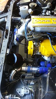

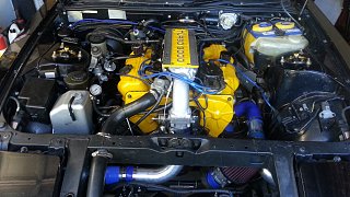

    I replaced the neck as seen in my pictures below.
    In my setup I do not use a spacer, but I gutted my plenum and put a 10MM thick top plate on. The hood doesnt close with the fancy plenum finish. I cut the front support of the bonnet but I believe there could still be some rubbing.
