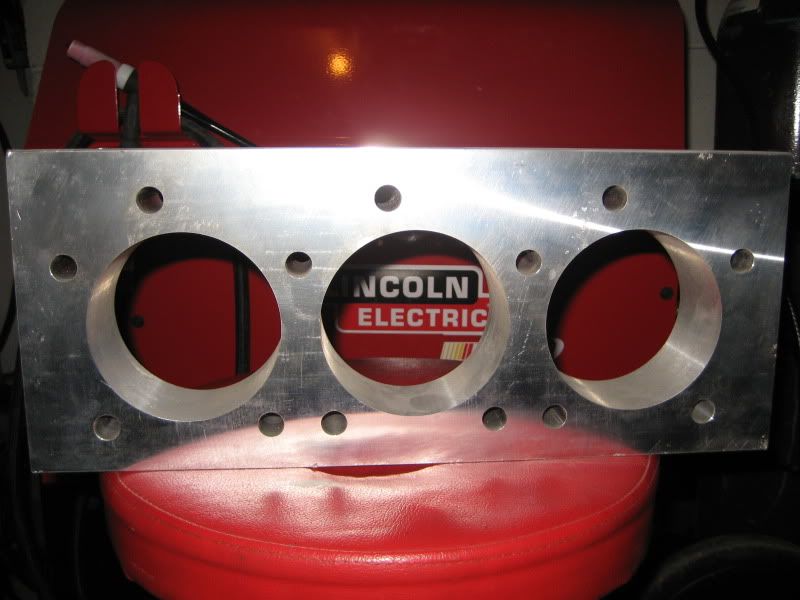

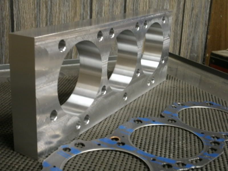

    Here is the VG33 Torque Plate for rental. It is perfect for VG34's, and might work on larger (let me know your bore size). Its 6061 billet, CNC machined. The two extra holes are for block dowels.
    Sorry its blurry, apparently too shiny for my camera?
