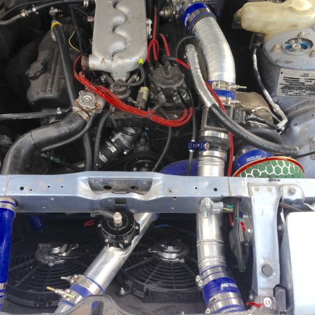

    So I'm finishing up the last of my turbo kit/intercooler piping re-work. Have a few questions....background info: Blow thru maf configuration. Have a 7" long pipe 3" pipe where the MAF sits about 4.5-5" in the pipe. 2.5" piping inlet/outlet for intercooler.
    MAF location:
    How far away from the TB should the MAF sit? Does it matter?
    How much straight pipe do I need before and after the MAF?
    Will reducing the 3" pipe into a straight 2.5" pipe be the same as putting the air into a bend after the MAF?
    Is 3" pipe overkill for a set-up from MAF to throttle body? Will it even see any gains with 2.5" pipe from turbo to intercooler then 2.5 outlet from intercooler to MAF then 3" from there? I'm just wondering if streamlining the air from the MAF the whole way makes sense or not. Keep in mind this will be a > 600rwhp set-up.
    Usual Z31 suspect: Garage Queen (aka broken)
    You want the MAF at least 6" away from the throttle body. Ideally you want at least 6" straight before the MAF as well. Honestly with the IC being 2.5" I would make all of it the same.
    This was my MAF placement when I had one. Was making 400whp on a crappy JWT 3BAR ECU
    about here
    My setup runs perfectly stable My plan was rather than having a straight section and a bend with a shap intersection was to just make the entire length bend very very gently. IC cold side is 2.75 so the step up to 3" is very minimal.
    My BOV is also on the hot side, it dumps hot air and i don't get compressor surge so meh.
