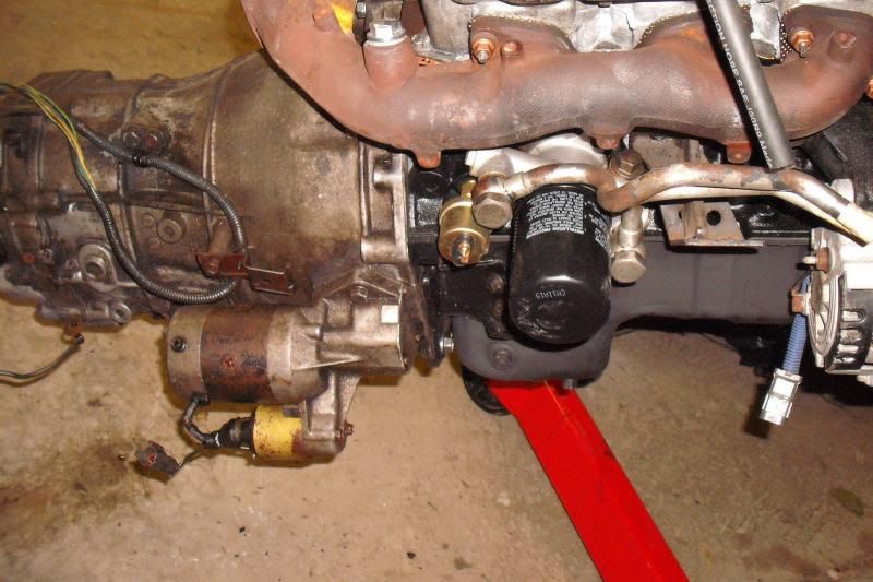

    First thing to remember is I already had a FS5R30A transmission in my car since it's a Shiro.
    Since the two transmissions are very similar I just pulled the bellhousing off of my busted up 30a and swapped onto the new Z32 unit. The bellhousing swap was straight forward, no modifications needed. Using my bellhousing I am able to retain my Z31 DXD clutch, Fidanza flywheel and stock starter.

    RS5R30A with a FS5R30A bellhousing and stock Z31 crossmember
