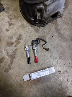

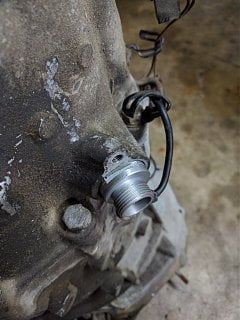

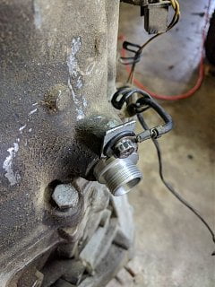

  • http://www.frsport.com/Nissan-32702-…y_p_32135.html
    I've been searching around looking to do this swap myself and apparently some guys have used these speed sensors. It fits in the Z32 transmission but it's a mechanical speed sensor. The Nissan part number is 32702-02G17
  • Originally posted by BLITZERKING1 View Post
    Correct. This should be the part number for 86-97 V6 2wd 5-speed Hardbody/SUV/etc. You can still get it from Nissan for ~ $34.00.

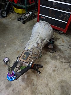

  • This is where I am at with my swap so far. I bought a 90 Z32 NA transmission from a junkyard today for $140 and a 90 Z32 NA starter for $50. The speed sensor I ordered from courtesy nissan for about $35 with shipping.
