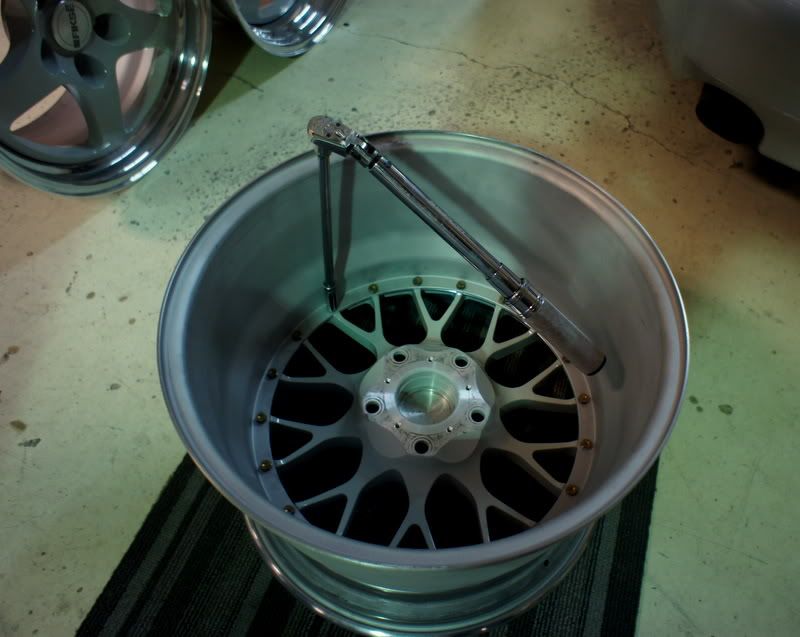

    Step 3: Torque down the hardware (you may also choose to torque down the hardware at the very end, this helps with not having a bubble form in the silicone). With Fikse and Kinesis wheels, which use relatively small, M6 hardware, torque spec is 15 ft lbs (fikse = 14 ft lbs, kinesis = 15 ft lbs). Do not over-torque. With wheels that use larger M8 hardware, torque spec is usually around 18 ft lbs. Torque in a star pattern, rather than just one after another in a row. Do not use a cheap, autozone style torque wrench. Borrow a good torque wrench from a friend if you have to.

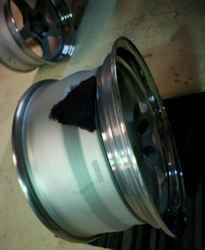

    Step 4: Lightly scuff up the mating surfaces of the outer lip and inner barrel with scotch-brite or light sandpaper.

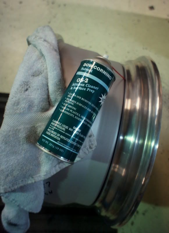

    Step 5: Clean the mating surfaces with some rubbing alcohol on a rag, or surface prep.

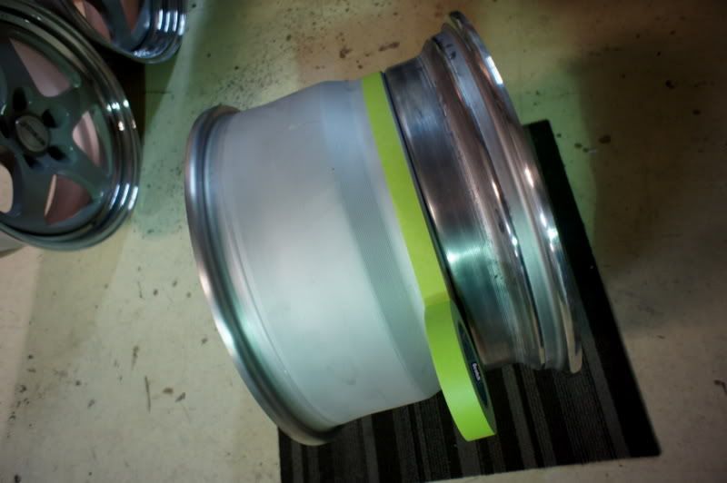

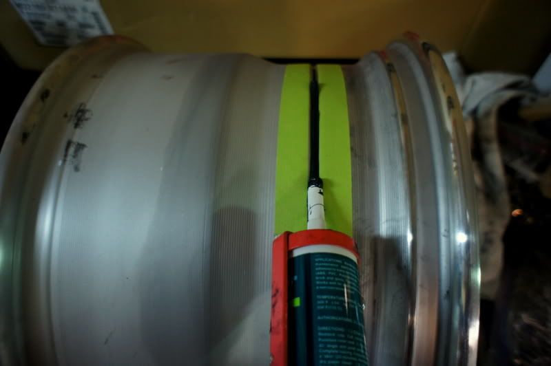

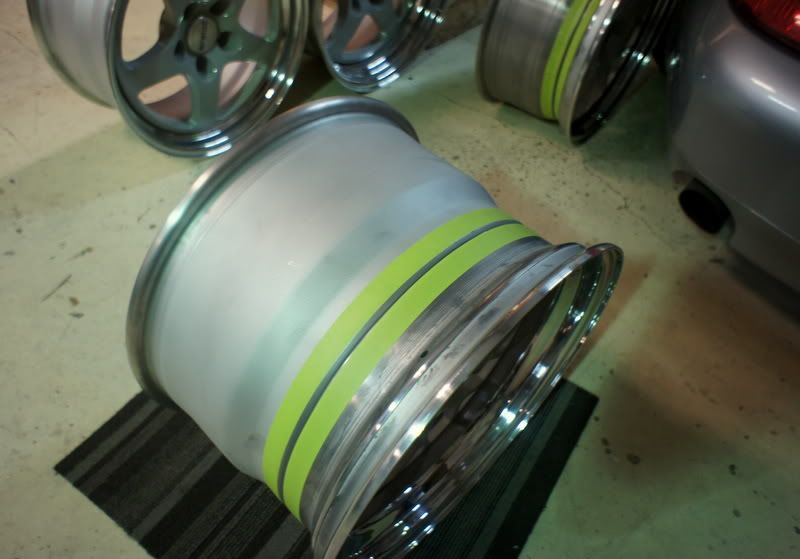

    Step 6 (optional): Mask off the mating surfaces so that you'll end up with a clean silicone line on the barrel and the lip.
    Step 7: Seal with a non-acid curing, adhesive RTV silicone. Slowly lay down an even bead all the way around, with the angled cut tip of the tube facing down.

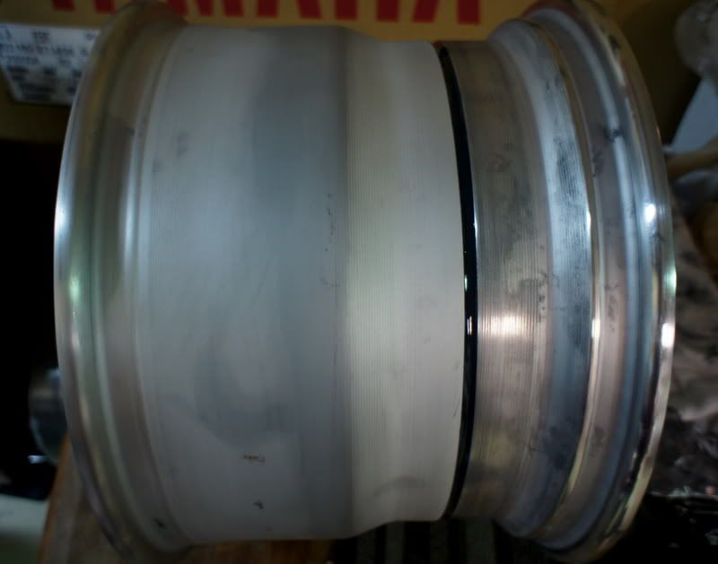

    Step 8: Carefully smooth the bead with your finger, applying just the right amount of pressure so that it correctly seals the mating surfaces; you want a smooth, even amount of silicone. Make sure you don't have a bubble in the silicone. Often times, a bubble forms because the trapped air has nowhere to go. One way to combat this problem is to not torque down the hardware until after the wheels are sealed & cured. If a bubble forms, just pop it with a razor blade or something sharp laying around, and smooth back over it with your finger.
    Step 9: Remove masking tape before the silicone cures.
