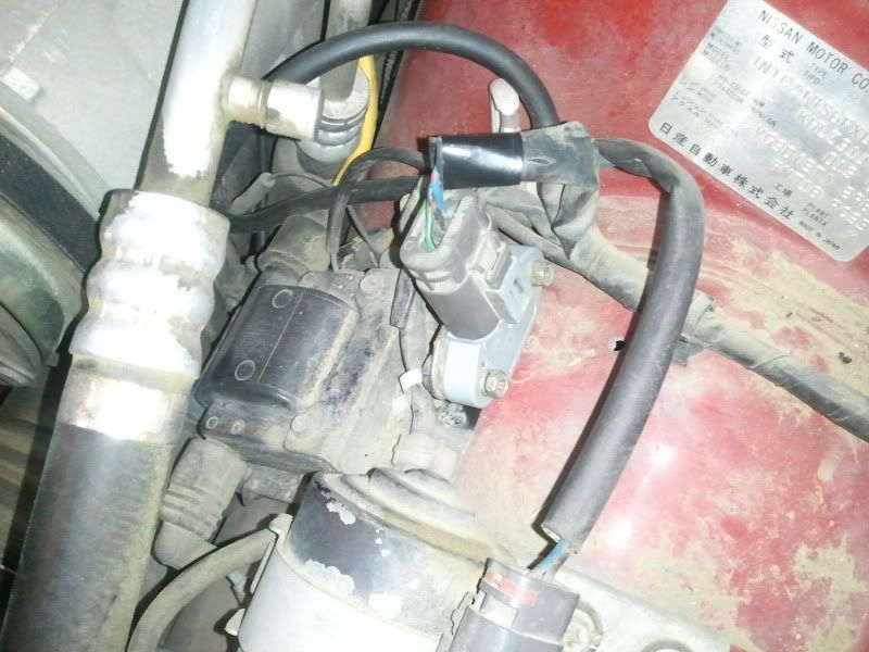

  • Alright so this thread again. I've been having a ton of problems with my car dyeing on me and not starting here lately. I was told it's either the CAS or the ICM. I did some research online and found a post where someone suggested pooring cold water on teh ICM. When I did this my z started right up. So I immediately got online and found this thread. I replaced my ICM today with a PRW-2 and was unable to start it. I don't know why? Is there any way to test my new ICM? Or maybe my CAS is also bad? When i try to start the car you can hear the starter turning but nothing happens. HELP!!
  • did you swap the wires that were described in this thread? if the answer is yes, then go ahead and change your CAS since it's obviously not the ignitor.
  • I did move the wires around. I think i went blue, black, and green when looking from the back side with the clip facing up. I did purcahse the ignitor used from ebay, so is it possible it's bad? As far as the CAS is concerned, I haven't a clue what I'm doing. Any suggestions because I'd like to do it myself. Any good write-ups? The shop i took it to quoted me at like $300~ for parts and labor.
    Thanks.
  • verify your wiring and try another ignitor. the fact that your car used to start before and it doesnt now (even though it started like crap before, as you said) is a clear indicator that something is wrong with the wiring or the ignitor. once that's solved, you can look into fixing the cas if it still starts rough.
