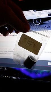

    I've got a mild steel 18x1.25 bung from the Innovate wideband kit P/N 3839 that i'll never use - it's the tall bung, not sure if that makes a difference? cover shipping and it's yours
    from what i've read ideal WBo2 placement is 18-24" downstream, with at least the same length behind it.You'd probably be better cutting away and welding in a plate and bung over the flub-up
    I'll take it man, thanks!
    Can you shoot me an email to zkarma@gmail.com? I can't PM until i clean out 446 messages or something from my messages folder, cleaned out a bunch but the number isn't going down.
