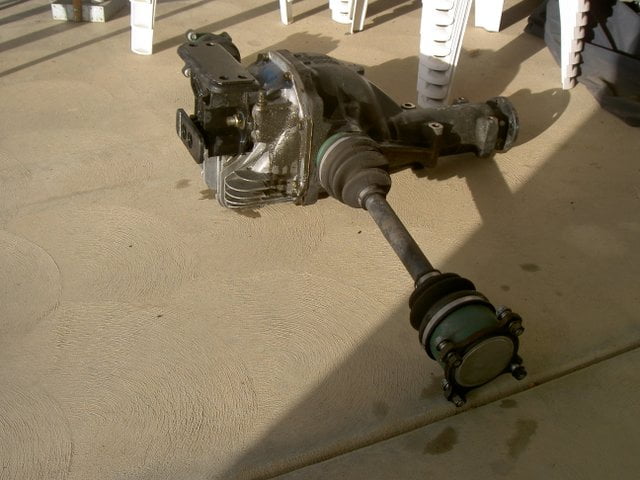

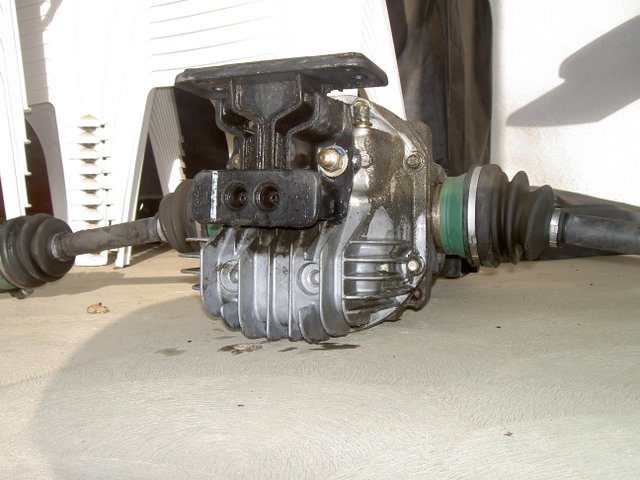

    LSD on the Shiros *usually* have an orange sticker that says "LSD" on the side of the finned cover (have not found this on regular 87-89 turbo CLSD's). Also look for the telltale rib structure on the 30A tranny as well as the slanted shifter plate.

    Or jack it up and get both rear wheels off the ground and spin a back wheel. Both wheels will spin the same direction if its a LSD, if it is open one will spin the opposite way.
    If this helps, here's a visual of what the VLSD should look like:
